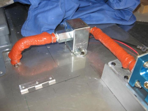

Studied up on fire-shielding, then fitted the fuel line from the firewall pass-through connector to the fuel pump, and from the fuel pump to the gascolator. Fitted the fire-shielding, making sure all fuel line rubber was covered - then safety wiried the fire-shield in place.

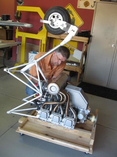

Fitted the engine mount to the engine so some exhaust planning could be done. Need to find someone to do some tig welding.

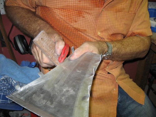

Continued work on the centre/fuel console - making up the fuel console backing plate here .....
Fireshielded fuel lines.
Fitting the engine mount and exhaust.
Making up the fuel console
