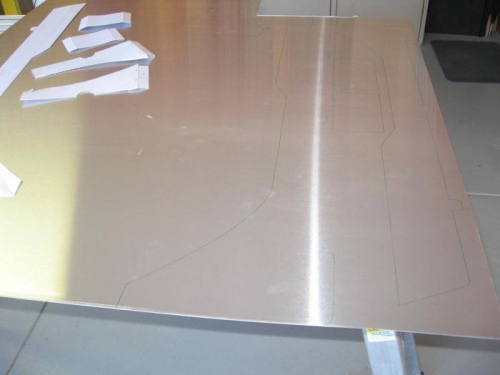

Made up console mock-up v6 - the final cardboard version! Pulled it apart and traced around the pieces on the 1.5mm alloy sheet.

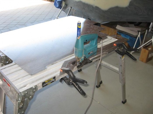

Started using the nibbler to cut the sheet but I could see there would be substantial finishing filing as the nibbler left a very erratic cut line. Changed over to the jigsaw with a stainless steel cutting blade - worked much better. A cleaner and much straighter cut.
Cut out all 5 pieces to make up the console.

Console pieces copied onto alloy
Cutting the 1.5mm alloy sheet with the jigsaw
