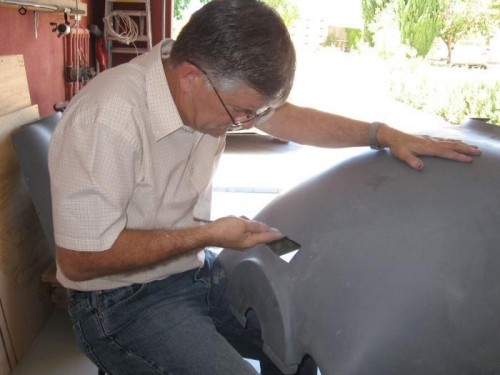

Trimming the cowl vent hole for the oil cooling duct.

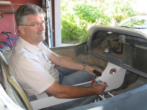

Making up cardboard console #6
