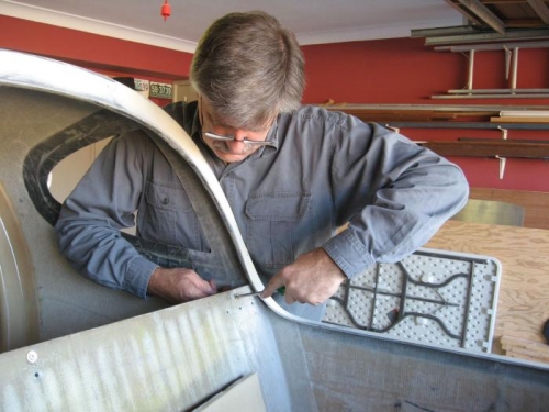

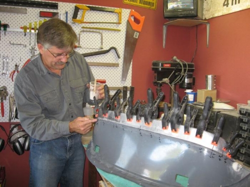

Finished bending the 1.5mm alloy to form the glare shield. Flocked it in place. Will drill and rivet it once it is firm.

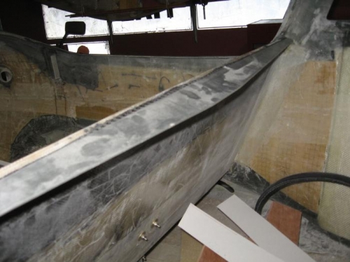

Moved the seatback brace up to be level with the top of the seatback. Made some small alloy extensions so the brace meets the fuse sides - flocked the ends of the brace to the fuse. Just making sure the brace cannot move backwards should a HEAVY person lean on the seatback when boarding.

Clamping the glare shield to the supports.

Brace relocated to the top of the seatback.
