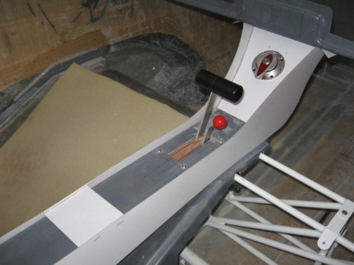

General day - more sanding and filling on the gear fairings and wheel pants. Main job was to make up templates for the console and glare shield. Both took 4 complete versions before they fitted properly. Will make at least 1 more console template to widen the top to blend more with the bottom of the panel.
Visited the wreckers and bought some face vents (from a Mazda 3!) and will see if they can be fitted - standard supplied vents look anf feel cheap. Same as the fuel selector in fact - the one on the console is a milled alloy selector from Aircraft Spruce (as is the throttle quadrant). The things you touch need to be good quality if the plane is to feel solid and well made.
Fitting fuel selector to console
