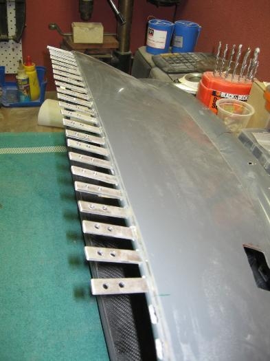

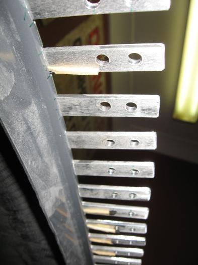

Continued work over the last 3 evenings to drill all the holes and epoxy in the extension "fingers". Drilled double holes in both ends of the "fingers" to allow a good grip for the epoxy.
Flock epoxied all 36 "fingers" in place.

1" inside with 2" protruding.
Adjusted with matchstick wedges to get alignment.
