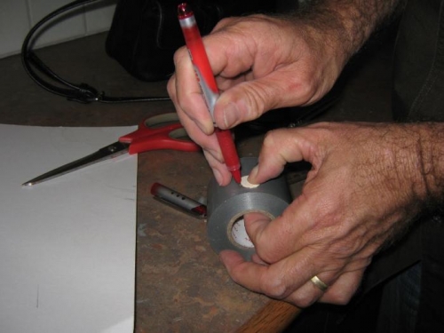

Cut round pieces of duct tape to cover all bushes, bearings and thread holes - mainly in the wings. Keeping the paint out so we don't have to re-tap all the holes.
Cardboard round template x 3 sizes

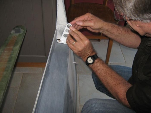

Fitting cut tape to bearings

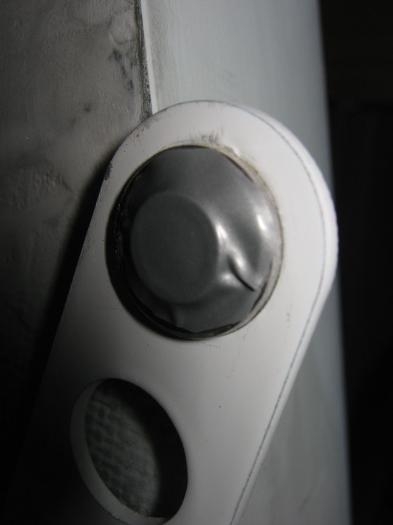

Taped ....
Taped ....
