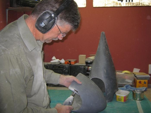

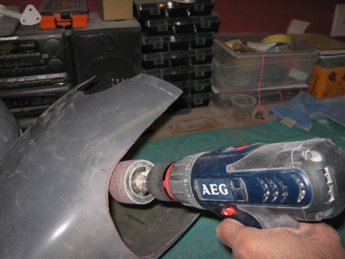

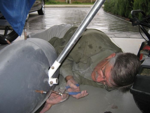

Brief Description:  Final trim and fit of main gear wheel pants.
More sanding of control surfaces - but inserted a change by way of the final fit of the main gear pants. Filled all wrong holes, fitted and trimmed (4 or 5 tiles for each side) until had an even finger width clearance all around the tyre. Fully sanded and finished the pants - now ready to fit the leg fairings.
