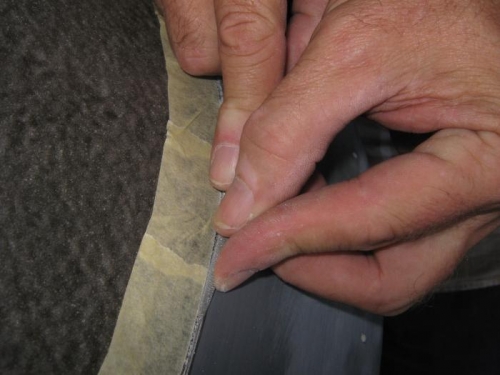

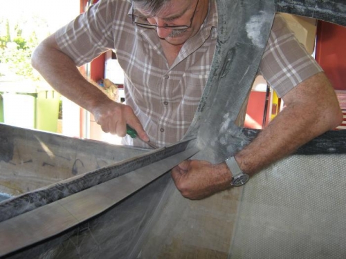

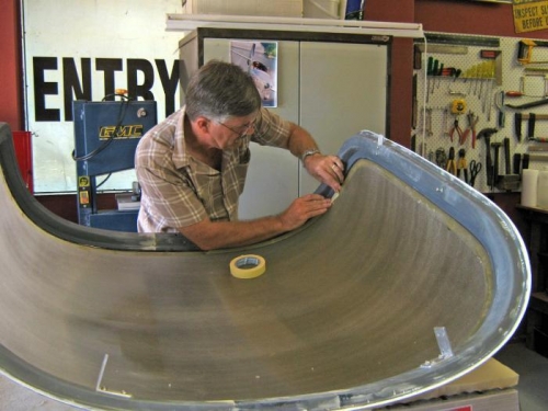

Then pulled out the canopy again! The joint between the canopy itself and the canopy frame was pretty poor - the resin had extruded a little on both the inside and outside as the frame was attached to the canopy. No easy way to smooth the resin and tidy the joint - so I masked the canopy and spent most of the day very carefully and filing and sanding the joint smooth. The canopy frame itself still need sanding and more filling - so I sanded and filled .... Perhaps one more day on the canopy will have it ready for painting.

Very slowly filing the canopy to canopy frame joint.
Working on the inside joint.
