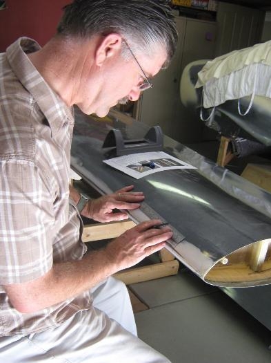

Fiddly measuring job - the manual is not clear and the first instruction is wrong (cut parallel to the end of the wing - it shoud read parallel to the leading edge).

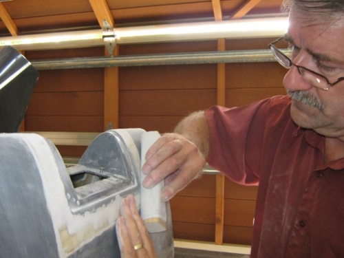

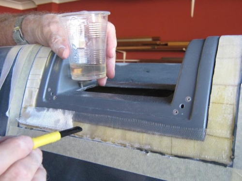

Then I trimmed the cutout until the mount fitting neatly in place. Then sanding the gel-coat to make a joggle area around the mount. Then glassed the mount in place and started filling.
More filling and sanding to go to get the wing surface smooth right up to the cut-out for the clear cover sheet.
Locating the area for cutting out
Glassing the mount into the cutout in the wing leading edge
2nd fill and sand - more to go ....
