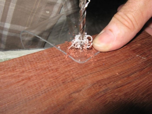

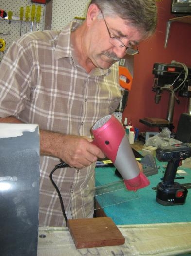

Drilled the clear cover for the landing light - after heating the sheet so it wasn't brittle (though the air tempurate was close to 40 today - I still heated the sheet to make sure of no splitting). Then match drilled the mount. Then used 3/32 countersunk alloy rivets to locate the nut plates behind the mount so the clear sheet could be screwed into place.
Heating the clear sheet
Drilling with a drill bit with the back rake angle removed
