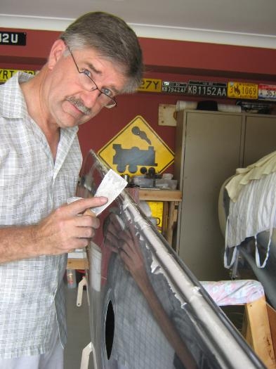

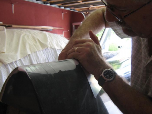

Brief Description:  Filling and trueing the wing leading edges
Filled, scraped and sanded bothy leading edges. Repeated 5 times to get a good, true and consistent curve with a reasonable finish. Made a 2ft long block to keep the sanding true.
Microballoon filler on the leading edge of both wings
Using a piece of thin stainless to re-form the leading edge.
