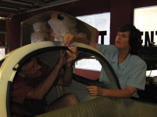

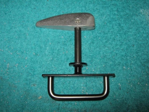

Finished making the canopy latch. The inside handle fouled the rubber seal as it passed - so ground 3mm of the side of the handle to clear, then repainted the latch and assembled again.
Drilled and bolted the striker plate in position on the top fuse lip.
Then mounted the latch in position and assembled - all works well now!
