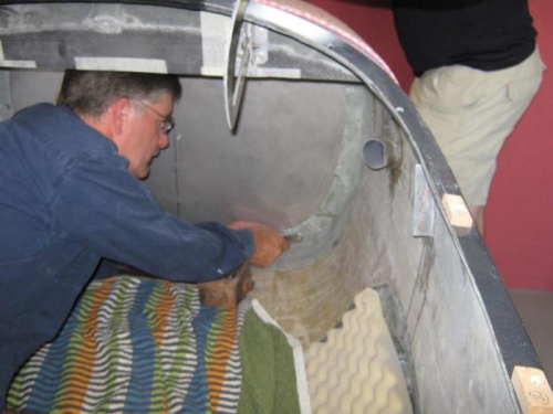

More endless work trimming the skins to fit the canopy. Skins now cover 4mm past the inside canopy frame - and have been trimmed and smoothed. Will taper the top edge smooth and start screwing (rather than clecoing) the sknis in place. Screws are required so pressure can be controlled (cleco pressure is not adjustable).

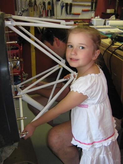

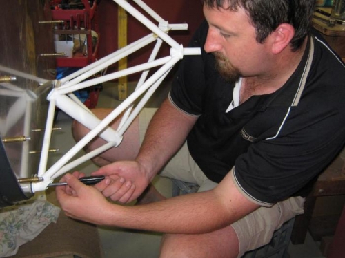

Mounted the engine mount so we could locate the mounting holes through the firewall and firewall bulkhead. Need to do this now so we can position the rudder pedal support brackets so they miss the engine mount points.
Danielle supporting the engine mount

Rodney tightening temp nut to hold mount
