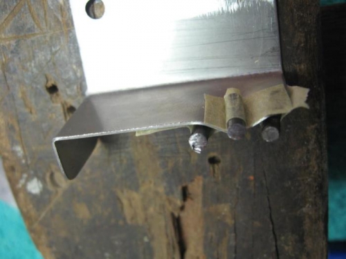

Another fun job. The only thinking required was to work out how to put "vee" stop in the lower edge. Decided to cut 1/2 lengths of spare elevator hinge pin and tape them in place as per below - then simply put it all in the vice and clamp it up. Worked fine.

Putting the
Putting the "vee" stop in

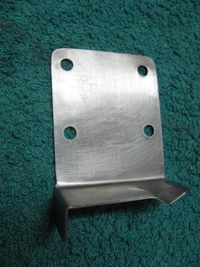

iniahed striker plate for overhead latch
