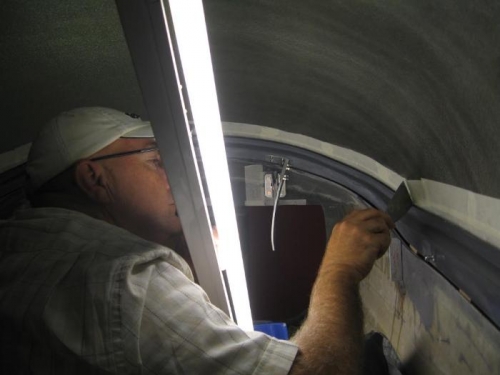

Brief Description:  Finishing the inside canopy to frame joint
Once the canopy had been strapped and taped into position, the inside joint could be tidied. The gap was quite consistent at about 1/16" all around. Got the bright light inside to clearly sight the joint and get a very smooth edge finish.
Cutting out the excess flock and filling  the few gaps
Doing the final smooth and trim
