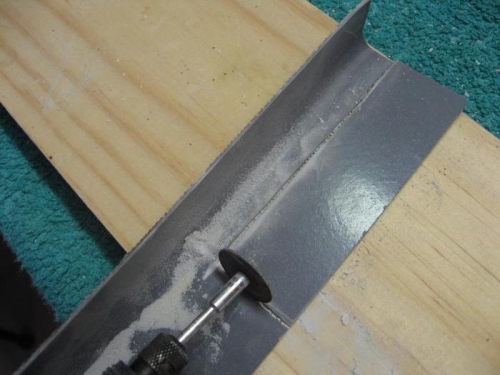

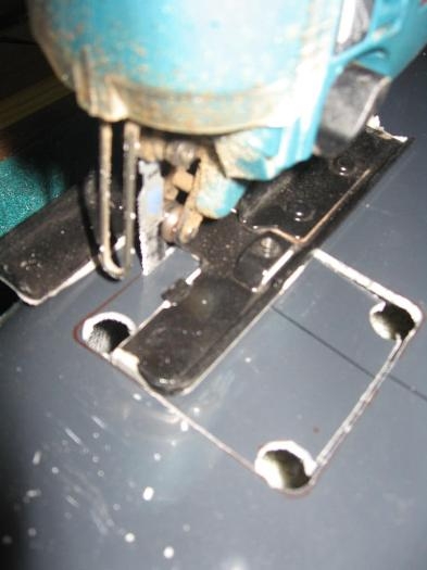

Brief Description:  Finishing up trim tab servo access hole.
Located and cut the access hole for the trim tab servo in the underside of the elevator. Placed the servo in position and clecoed the control horn onto the tab. Fitted the rod end caps and measured the control rod required length. Cut the control rod, then fitted the whole assembly in place - and marked & drilled the mounting holes for the servo. Retested the servo and tab action.
Widened the access hole to allow for the joggle, then cut the joggle plates from scrap sheet. Flocked the joggle plates in position. Elevator trim all done for now.....
Cutting the access hole in the underside of the elevator
