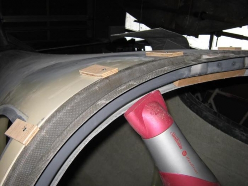

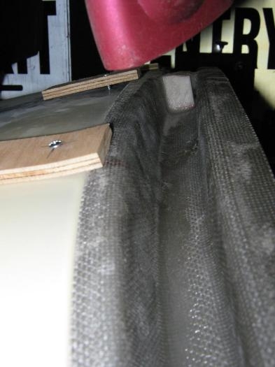

Did some more trimming of the canopy frame - having the rubber seal installed gives a much better idea of where the canopy will sit - but the top of the frame didn't follow the contour of the fuselage. The centre section is 1/2" too low (too flat). Called Dennis (Australian agent) and he advised to remove the rubber seal (to protect it) block the low centre section up and clamp down the two side curves - then apply heat to change the curve in the frame. Repeatedly heated and cooled (with a wet rag) the curves - then left the frame clamped. Will see in the morning if the curve has changed enough for a reasonable canopy fit.

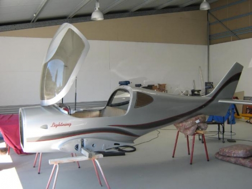

Made another motivational visit to Peter T at Serpentine Airfield - he has just had his Lightning return from the painter - and it looks beautiful! Can't wait for Peter to get his in the air .........
The outside clamps
The outside clamps
Inside block & heat
Inside block & heat
Peter T's Lightning
Peter T's Lightning
