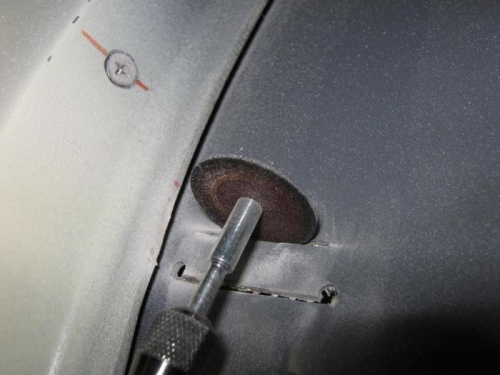

Continued filling and sanding the top HS to VS joint, and the top fuse joint. Having to fill the top of the fuse (behind the canopy area) quite a bit as there is a depression at the joint. The fill area is up to 8" wide (though very shallow).

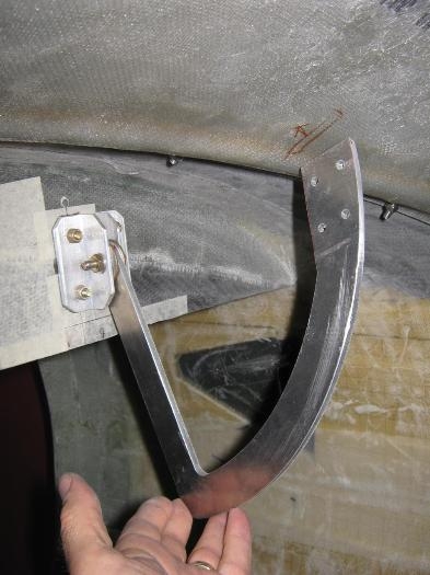

Refitted the panel and canopy brackets so the panel could be cut to allow the brackets to pass thorugh. Marked the location on the underside and drilled the corners - then used the dremil to cut the holes from the top. Kept widening the hole until the bracket could travel unhindered.
Having the bracket bent (new mod) means the arm "moves" as it tracks through the panel mount top. Means much larger holes!
