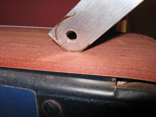

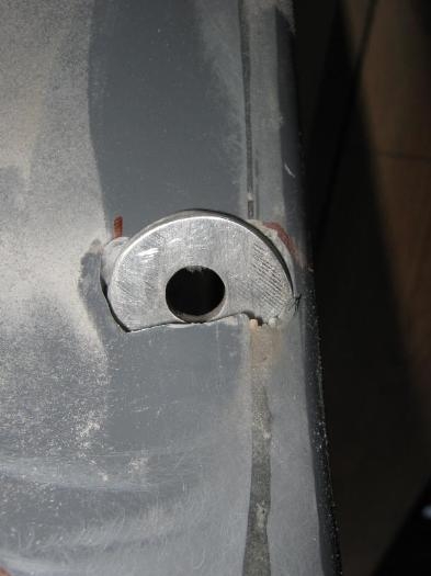

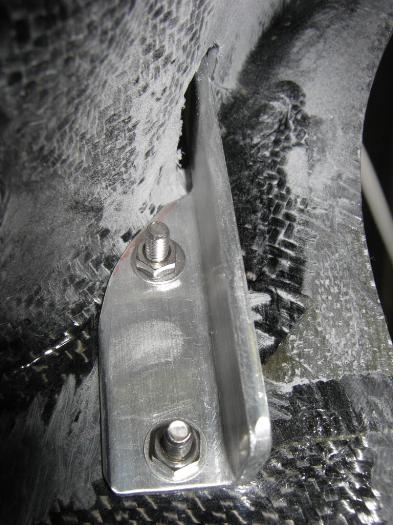

Finished making the gas strut brackets then positioned and cut into the panel. Very slow work trying to align the brackets so they protruded enough to fit the ball joint on the outside - with enough space to get the nut underneath on the inside of the panel.
Expoxied and flocked in place just to make sure ...
Linishing
Linishing
Trial fiitted without nyloc nuts
Top protruding through the top of the panel.
