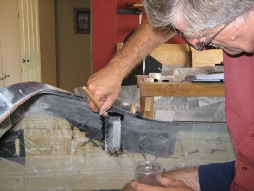

Brief Description:  Trial fitted panel and located side brackets
Trial fitted the panel and bolted in place. Will have to trim fuse lip to get even clearance around panel top for the edge rubber. Cut out the ends of the panel - made up the angle pieces to mount the panel sides. Glued them in place with 5 min expoxy, then flocked around and finally glassed over.
Did first fill and sand of the top side HS to VS fillet. Filled top fuse joint down full length of aircraft.
Glassing the panel mount bracket in place.
