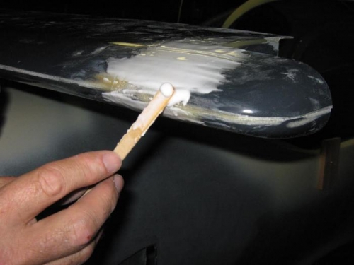

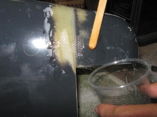

Second part of the elevator horn modification - attaching cut off portion to the HS. Glued on with resin, then glassed over joint. When dry, started the filling, sanding, filling, sanding routine ... First experience using microballoon stretched filler. Sands well.
