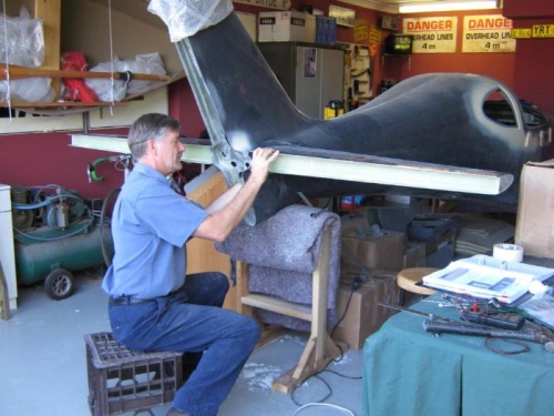

Brief Description:  Fitted HS up to marking AOI bolt holes.
Finished fitting the HS brackets - made sure were as instructions and true. Had to remove and pack out as the hole spacing was 1/2 inch narrower than the spacing in the spars. Bolted all together and marked AOI (Angle of Incidence) bolt holes in forward part of HS. Removed HSs yet again!
First fit of the HSs
Smaller hands fitting nuts to HS spar bolts!
