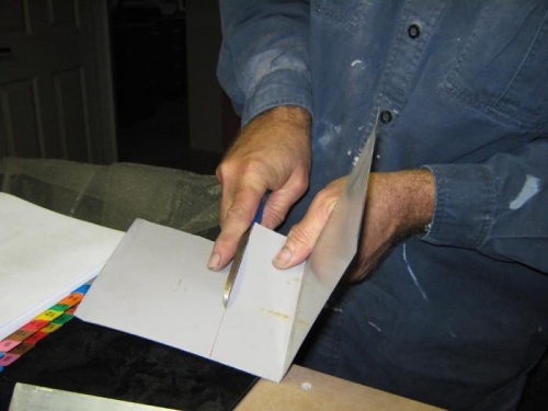

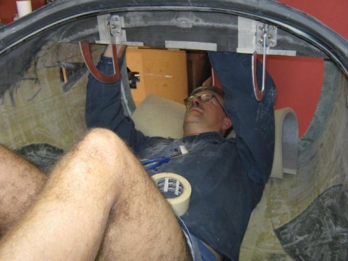

Fitted the canopy hinge/brackets to the fuse frame. Went looking for the 1.25 x 0.125 flat alum to make the brackets on the canopy frame end of the hinges - couldn't find it so called Dennis (Lightning Australia). Dennis advised new technique to attach canopy brackets to the canopy frame - involves twisting the brackets outward until they are square to the canopy frame, then using a piece of 2" angle to attach to the frame.
Fixing hinges to fuse frame.

Cutting a template for the new frame brackets.
