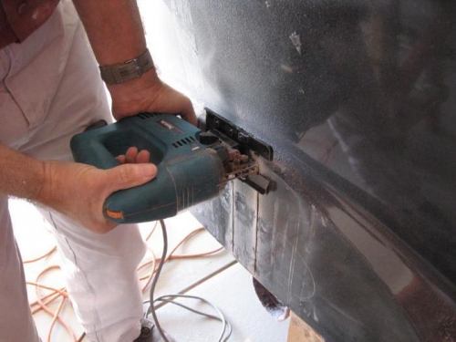

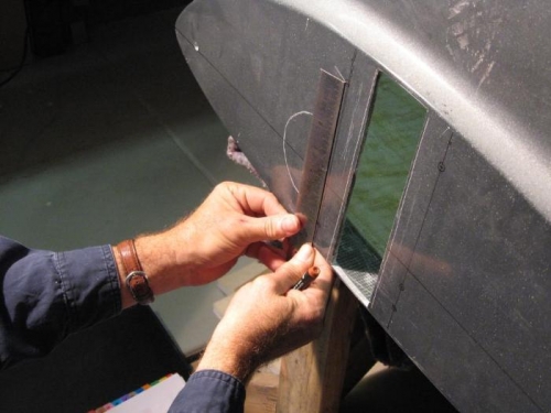

Brief Description:  Prepare to mount spar boxes
Measured spar front to wing front on both wings - used this to calculate cut out in wing root for spars. Cut holes with dremil cutter, then trimmed with jigsaw on very low speed and finished with 120 glass paper. Measured spar box hole location (checked!) then pilot drilled and drilled holes out.
