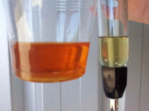

Spent the morning hunting the engine miss when running on 1 mag. Today's mystery - the difference in colour of the fuel drained from the carbi bowl and from the gascolator and fuel tank. Fuel from the tank and gascolator still looks at is should for RON 98 Mogas - but the fuel in the carbi bowl is orange. This has been the same each time I test the fuel before the first start up for each day. After the engine has been run, the fuel in the carbi bowl is the right colour ..........

Orange carbi fuel vs yellow fuel tank fuel?

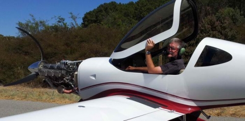

Re-gapping all the plugs.
Engine run test.
Engine run test.
