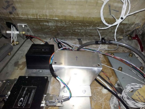

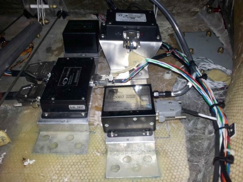

Received the repaired ADAHRS remote unit back from Dynon - no charge to repair - thanks Dynon! Tested it last time so bolted it back in today - then tidied all the cables from the panel back to the avionics bay under the baggage compartment behind the seats.
Routed everything carefully and cable tied everything in place.
Fired up the Skyview again and found more faults - traced all by one to poor connections. Replaced the offending connections, but still have one "earthing" fault. Will have to pull the panel out again and run continuity checks on all the wiring from the sticks. Pushing the PPT button affects the elevator trim indicator light. The only place they are together is in the sticks so may have to pull the sticks out again .....
Getting closer ...
Avionics bay at start of today.
Bay at end of day.
Bay at end of day.
Not the easiest place to work ....
