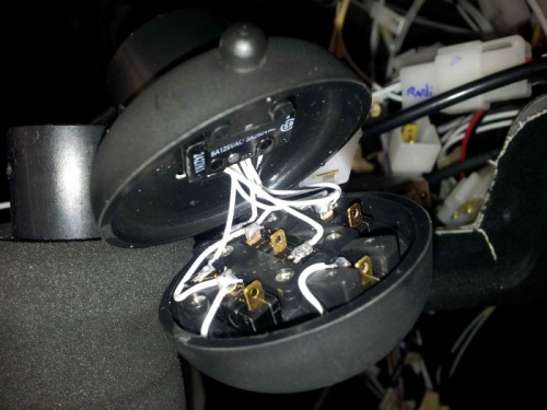

Spend the day checking all the radio system - took a while as it is the most complicated system in the plane. In the end I found 2 faults. One soldered connection had failed - probable from being pulled too hard with one of the many panel installs and removal ...

Checking inside the stick control ...
