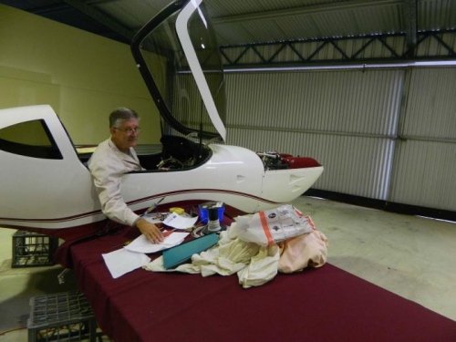

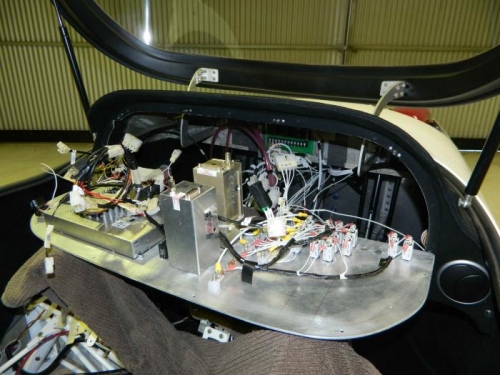

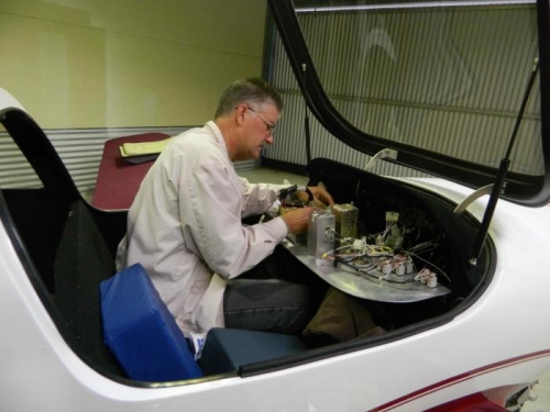

Another long and fiddly day adjusting cables and connectors - and adjusting routing to keep things as tidy as possible. Eventually got the panel back in. ADAHRS still doen't work, even after the cable was re-wired so I banged off an email to Dynon for some advice. And the radio system doesn't work - left side PPT no doing anything buy right side (stick) is activating the radio. And when a head set is connected no sound can be heard and no voice is transmitted. So I'll now need to check continuity and connections right through the radio system. The EMS works well! And the GPS works well!
Convenient wing ...
Convenient wing ...
Panel ready to be connected.
Connecting ...
Connecting ...
