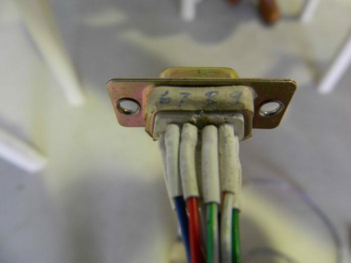

The Skyview main unit did not detect the ADAHRS remote unit when I fired up the system the other day - so today's task was to check the cable I made. Sure enough, continuity on the pins at one end of the cable didn't match the other end .... I had sequenced the pins wrongly on one end of the cable, running 6, 7, 8, 9 from left to right. Unsoldered all the leads then resoldered them 9, 8, 7, 6 from left to right. Rechecked the cable and now both ends match! Will now reinstall and see if the Skyview detects the remote unit .....

Wiring backwards 6 - 9
Wired correctly 9 - 6
