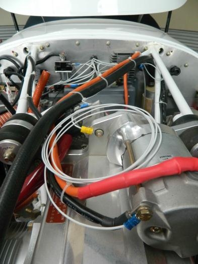

I was advised that the Dynon units (including the Skyview) are very sensitive to feedback along the earth lines so it is best not ro run the Dynon earth to a common earth or an earth bus. So I ran a separate earth through to the starter motor and main earth lead.
Then I spent some time tidying up the cabling after re-attaching the wings. Final task for today was to prepare the stick mixer assembly for installation.
Separate earth for the Dynon.

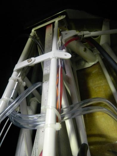

Slightly tidier cabling ...

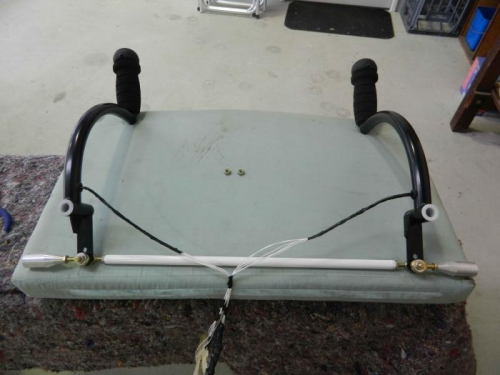

Stick misxer assembly ready for installation.
