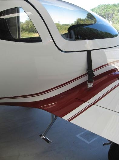

Flap in the up position - both sides matched.
