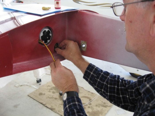

Ran the cabling and wired uip the landing light. Fitted the landing light and the clear cover.

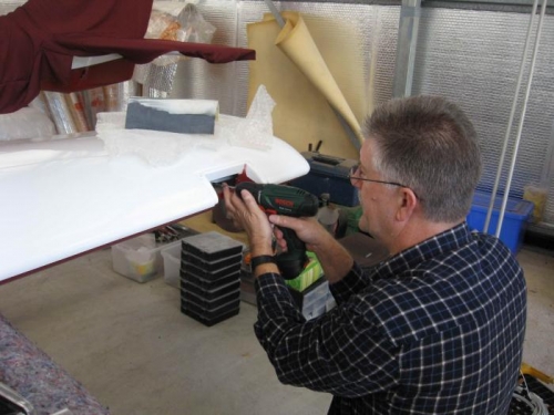

Drilled a 1 1/2' hole in on each side of the fuse to sight the fuel level sender "led"s so I can see them with a mirror when calibrating the fuel tanks later.

Final fitment of landing light.
