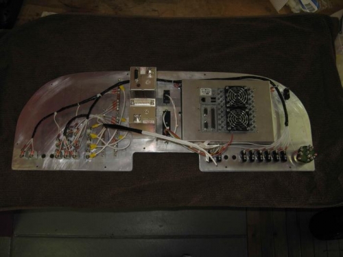

Brief Description:  Completed panel basic wiring.
Completed the last of the connections between bus bars, circuit breakers and switches. Tightened all screws and bolts. Grouped the cables where I could then trial taped them together. Adjusted the length of many cables (crimped on new lugs) to get the cables to sit tidily as a harness. Then wound black electric tape around cables to make the final harnesses.
Bought some blanking grommets and trimmed them down to fit the holes for the autopilot circuit breakers and switches. Not fitting autopilots yet so the holes in the panel have to tidily blanked off.
Started work on the flap position sensor. Made up some spacing tubing for the flap motor bolt. Started designing the mounting for sensor.

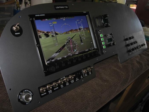

Panel basic connections complete.
Font of panel complete.
