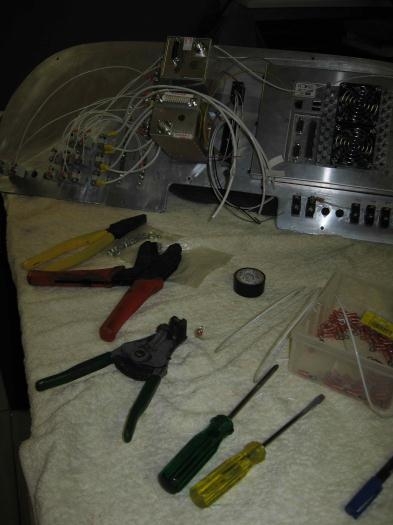

Date:  4-12-2012
Number of Hours:  2.50
Brief Description:  More panel work.
Wired up the heavy 10awg cable to the bus bar circuit breakers and bus bars. Did some route planning and started wiring. Wired the fuel pump in 16awg as it has a 10amp circuit breaker (16awg can carry 11 amp). All other wiring is in 18awg (can carry 9 amp) as all other circuit breakers are 5 amp or less.
Panel work progressing.
