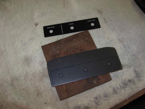

Need a back plate for the cable sub-panel - the engraved sub-panel is not strong enough by itself.

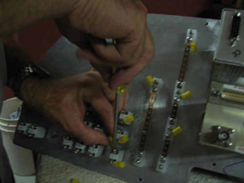

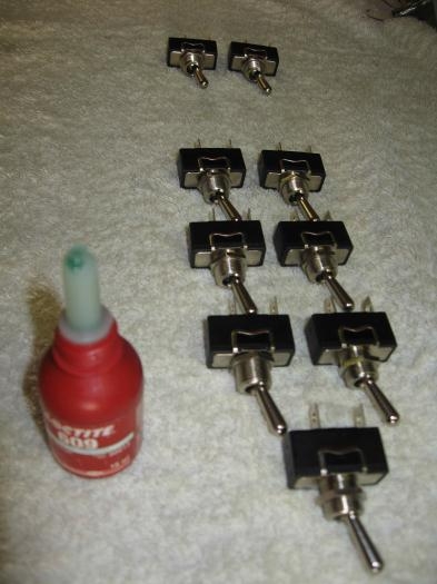

Set the depth of the switches with the back nuts - but they kept moving as I tightened the face nuts. So I pulled them all off and loctited them in position. Refitted them and they pulled up well.
Test fitted the cable lugs on the bus bars and circuit breakers to work out direction and clearances.
Making cable sub-panel support plate.
Loctiting the switch back nuts.
Checking clearances.
