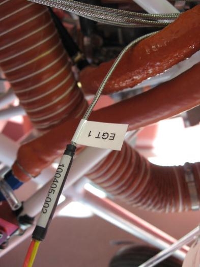

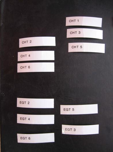

Brief Description:  Labeling CHT & EGT sensors.
Should have been simple - but a few issues - like which cylinder is #1 (looked up the manual and the most forward cylinder is #1). Had to untie the bundles to track each lead and lable the far end.
Thought I'd recheck the Dynon sensor instructions - right at the end it says "Make sure the sensor is under the plug closest the exhaust ......". So had to pull all 6 plugs on the LHS and swap over the sensors.
Temp sender lables.
Temp sender lables.
In place .....
In place .....
Cylinder head temperature (CHT) sensor relocated to the spark plug nearest the exhaust.
