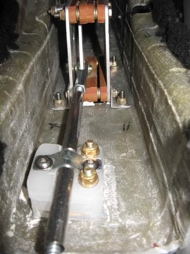

Finished adjusting the quadrant to take the connector for the throttle cable. Lots of assembly, stripping and reassembly...

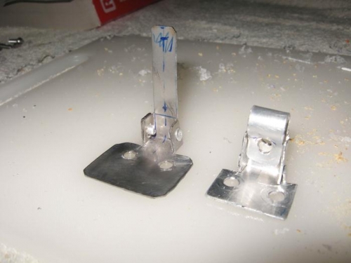

Had to work out a way to hold the outer cable on the throttle cable - after two tries with alloy and SS - ened up using a nylon block (laminated cutting board!). Refitted the console and the cable clears all obstructions.

Test models 1 & 2 - not strong enough.
Model 3 - much better.
