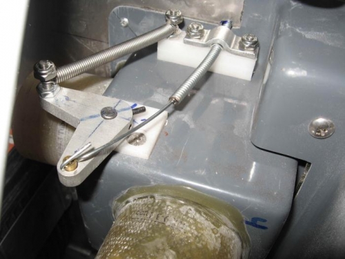

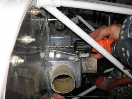

Decided to revert the carbi heat connection to standard - can't do everything as well as I would like if aircraft is ever to be completed! Unfortunately it requires an unsealed hole through the firewall - ie no way to use a gland with the standard set-up. Will seal with permatex - but will try to do a tidier job than that shown in the manual .........

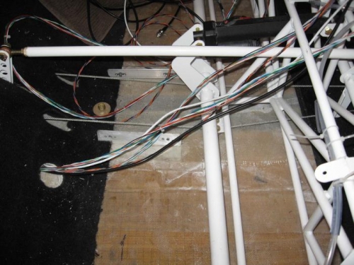

Back to wiring - cut the hole in the lower seat back to pass the wiring through. Decided to lay the wires on the floor under the seat (may put a mat over them) then up the outside of the center console toward the front where their is space under the seat. Going inside the console puts the wiring too close to the rudder cables - and I don't want to risk anything fouling the cables.
Using 90o angle drill to drill hole for  carbi heat cable.
Completed carbi heat cable.
Wiring coming forward through lower seat back.
