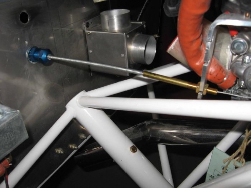

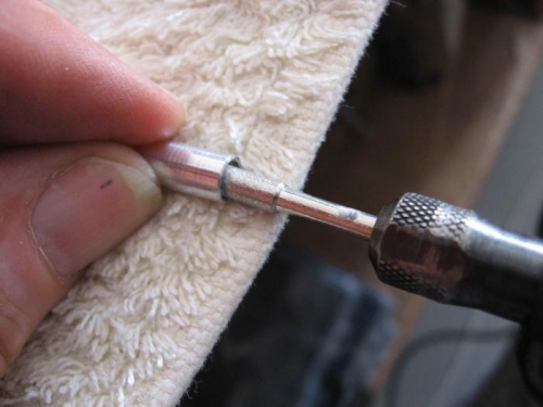

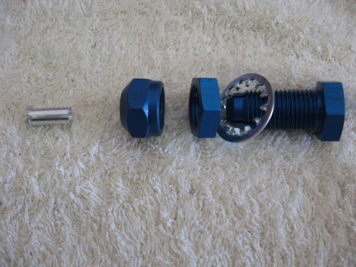

Received the Aircraft Spruce package at last - this order included the cable glands. I wanted a secure and fireproof way to seal where cables passed through the firewall. Lots of research lead to these glands - worked well exept the insert was just a little too thick for the cable so had to ream them out. Fitted the glands abd cut outer cables to length, then bent the inner rods and fitted.
Completed are the cabin heat, engine choke & carbi heat cables and connections.
Firewall gland exploded.
Reaming out the insert.
Completed choke cable.
