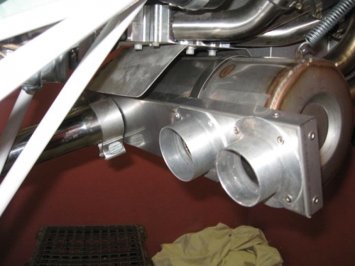

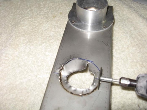

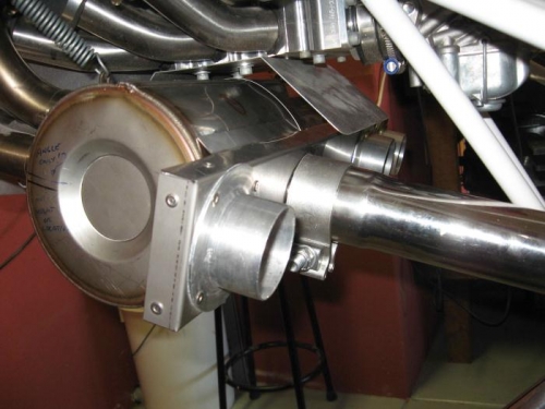

Started with the two heat muffs for the muffler. Because we are fitting the cabin heat as well as the standard carbi heat there are two muffs supplied. Rather than stack two muffs on top of each other, I located the hole to be cut for the exhaust pipe, then located the best place for the carbi heat scat hose - then removed the flange from the carbi heat muff and fitted it to the larger cabin heat muff. Then cut the slots to take the large clamps and fitted it all together.
Cutting the hole for the carbi heat.
Carbi heat outlet fitted.
Muff fitted over the exhaust.
