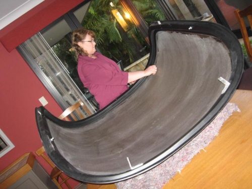

Sheryl completed the slow and painful job of removing the protective coating from the inside and outside of the canopy. Material came away OK but in very small pieces - so was simply time consuming .....

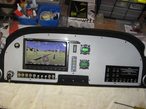

Build up and installed panel v2. Layout is logical and practical - with space behind to fix all instruments easily and get at all connections. We will use smaller subpanels for the switch set and the circuit breaker set. That way we can have those smaller panels laser engraved. All text - including the warning placards - is on those smaler panels. Also means we can drop those smaller panels to access switches or breakers without dropping the whole panel.
Sheryl removing the protective coating.
Panel V2 complete
Panel V2 complete
