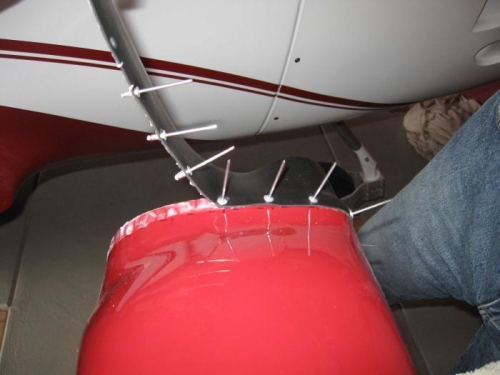

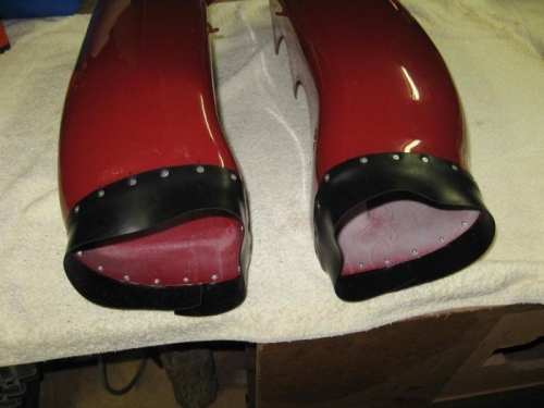

Riveted the rubber seal to the front of the ram ait ducts - but then discovered that the rubber can pull mpast the rivets if you pull had enough. So starded again and contact glued as well as riveted - worked well. Fited the ducst to the engine and trimmed the front of the rubber to seal against the engine cowlings.
Sanded the leading edge and applied contact glue
Rivet holes pre aligned.
Completed- ready for trimming
