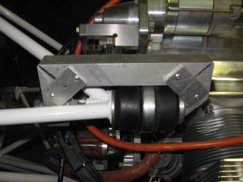

Brief Description:  Replacing the longer temp engine bolts with the co
Used the clamp I made for the last engine intall to compress the rubber bushes enough to remove the longer temp bolts and fit the correct bolts. Used the high temp locknuts as per the manual.
Home made clamp to compress bushes.

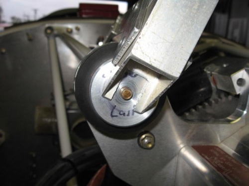

Bushes compressed with bolt showing.

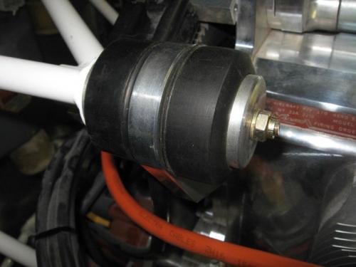

Correct bolt installed.
