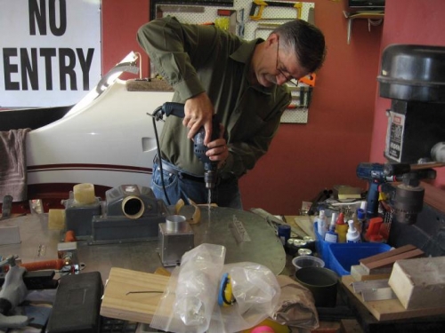

Tried fitting the fire wall a month ago - but discovered I had fitted the rudder assembly after I pre-fitted the firewall - hence 6 bolts had no holes through the firewall. Located the 6 bolt locations and drilled them through. Refitted the firewall and made sure the perimeter 33 bolts all had holes that aligned properly - ready for the final install.

Locating and drilling extra holes.
