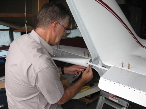

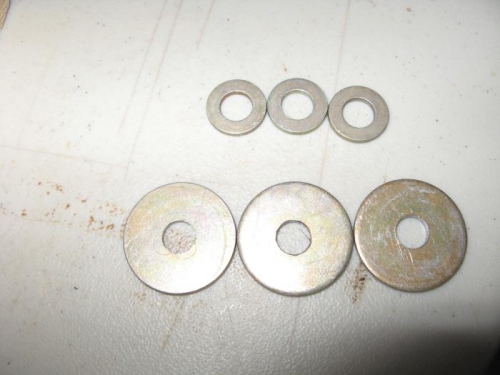

Thought about the nuts and bolts holding the elevator crank bracket - I had used ordinary washers. As the bolts and washers are pulling against fibreglass, large area washers would be better. So commenced a few hours of undoing and extracting the nuts and washers inside the elevators - working through the small access hole in the underside of the elevators. All washers now replaced with large area washers!
Adjusted the elevator torque tube - it can be safely adjusted with too much up elevator, and with too much down elevator - a good safe range. I will check the actual angles up and down on Peter T's plane then set this one up the same way for the test flight.
Removing the nuts and washers
Ordinary and large area washers
