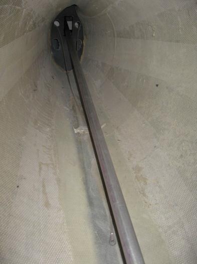

Brief Description:  Making & fitting elevator torque tube
Used the iPhone to check the travel of the elevator, then set it at 25 degrees up (as per manual) and measured the required overall length. Took off the length of the end cone fittings, cut the tube to length, fitted the second end cone, then fitted the torque tube. Elevator linkages now all finished .....
Inside rear fuse.
Inside rear fuse.
