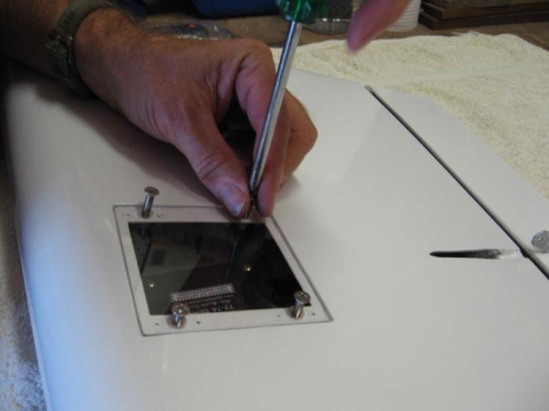

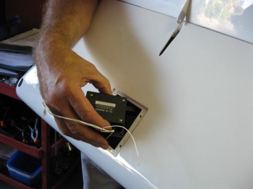

More work with new shiny parts ..... Fitted the trim motor - tricky as I made the access hole as small as possible to keep the elevator skin strong.
Then fixed in place the first of the clear acrylic inspection hole covers (Peter T's idea). It means that most inspections around the plane can be made with a torch without removing any covers.
Positoning the trim motor inside the elevator.
Fixing the clear acrylic inspection cover.
