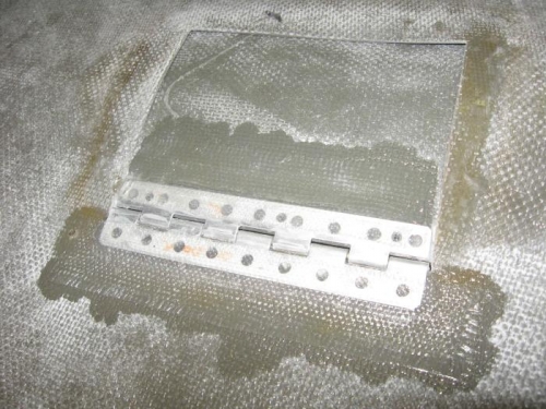

Smoothed the hinge areas, wetted out with resin, then glassed over both hinge halves.

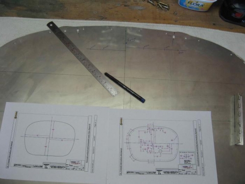

Cleared the benchtop and set up the firewall. Printed all the drawings and pictures that showed firewall locations. Found the vertical centre line (lots of averaging) then then horozontal datum line. Marked the mounting hole locations.
Glassed over both hinge halves
Printed all the layout drawings - collected pictures
Marking up the firewall
