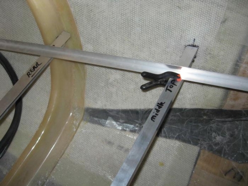

Baggage area floor supports
Made up end brackets for the middle support so the support can be removed to provide access to the rear fuse area. Flocked the brackets and support in place. When flock is set, I will unbolt and remove the middle support from the end brackets.
Middle support end bracket
Middle support held in place while flock sets
